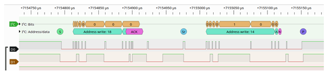

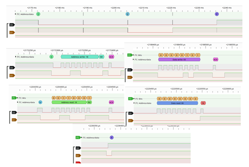

  • In this particular case it would help a lot with a logic analyzer trace of the working vs. failing, to find the exact difference (e.g. start, stop, restart conditions, length, transfer etc). Else I don't see any other way than to try and a fail a bit using i2c_transfer_dt() and various flags, but it could be something obvious we are missing here, so a logic analyzer trace would help a lot.
    Kenneth

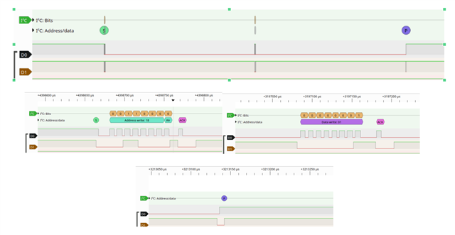

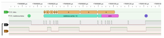

  • Working ok examples of the relay using i2ccl:
    i2ccl /dev/ttyUSB1 w 0x18 5 r 0x18 1
    i2ccl /dev/ttyUSB0 w 0x18 1 p
    Then in VS using a 9160DK:
    i2c_transfer_dt
    uint8_t wArray[1] = {0x01};
    uint8_t a = 0;
    struct i2c_msg msgs[2] = {
            .buf = wArray,
            .len = 1,
            .flags = I2C_MSG_WRITE,
            .flags = I2C_MSG_STOP,
    a = i2c_transfer_dt(&dev_i2c, msgs, 2);
    if (a != 0) {
        printk("I2C transfer failed with error %d\n", a);
    }else{
        printk("a %x \n", a);
    i2c_write_read_dt
    uint8_t wBuff[1] = {0x05};
    uint8_t rBuff = 0x00;
    uint8_t a = 0;
    a = i2c_write_read_dt(&dev_i2c, wBuff, sizeof(wBuff), &rBuff, sizeof(rBuff));
    if (a != 0) {
            printk("I2C error %d\n", a);
    printk("Status: %X\n", rBuff);
    i2c_write_dt
    uint8_t a = 0;
    a = i2c_write_dt(&dev_i2c, wArray, 1);
    if (a != 0) {
        printk("I2C write failed with error %d\n", a);

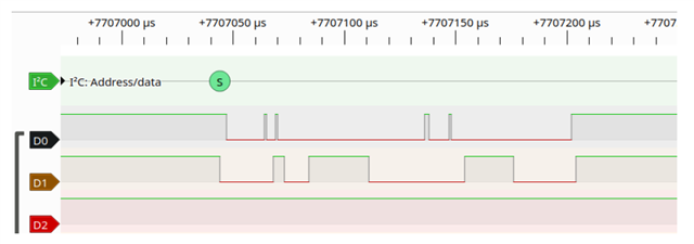

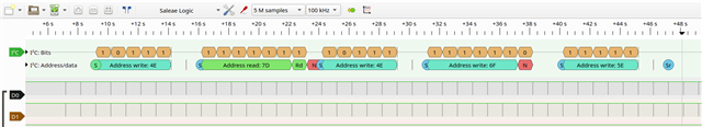

    The PulseView output is showing different Addresses, like 18, 14, 10, where I think they should all be 18.
    For now, not sure why this is so.
    Reused DevAcademy code for this test.

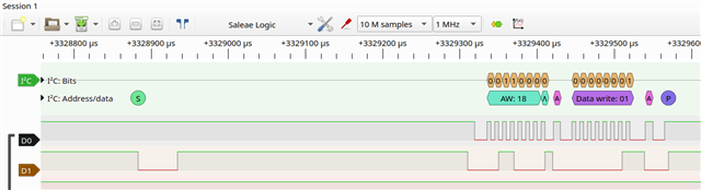

  • For comparison, here is the PulseView BME280 output for DevAcademy Fund L6-E1 v2.9.0,
    thank-you,
