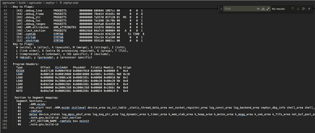

Section `_RTT_SECTION_NAME' can't be allocated in segment 2
I'm getting the following notice/warning/error when building my application (nrfsdk 2.9.0 w/ sysbuild, nrf9151dk board):
/usr/local/zephyr-sdk-0.17.0/arm-zephyr-eabi/bin/arm-zephyr-eabi-objcopy: /Users/kon/Workshop/GitHub/AgX/agmuster-workspace/agmuster/build/agmuster/zephyr/st0gBFbh: section `_RTT_SECTION_NAME' can't be allocated in segment 2
LOAD: .ramfunc _RTT_SECTION_NAME bss noinit
image.py: sign the payload
[1/10] Performing build step for 'mcuboot'
ninja: no work to do.
[10/10] Generating ../merged.hex

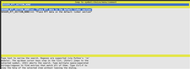

We are using this config. And the error disappears if I set SEGGER_RTT to n.
CONFIG_USE_SEGGER_RTT=y
CONFIG_SHELL_BACKEND_RTT=y
CONFIG_SEGGER_RTT_BUFFER_SIZE_UP=4096
RTT seems to be working when I flash. Is this an expected message? If not, what's the proper way to address?
