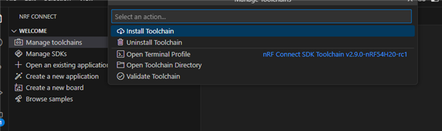

  • Hi Stefan
    Could you try to open a terminal instace where you have loaded the toolchain enviroment
    For example like this:
    And then try to install the dependencies as mentioned here
    Regards
    Runar

  • Hi
    It seems to me like you are running cmake when you are trying to build.
    Could you rather try with the following
    west build -p -b nrf5340dk/nrf5340/cpuapp
    And post the output
    Regards
    Runar
  • I can now build blinky and run it.
