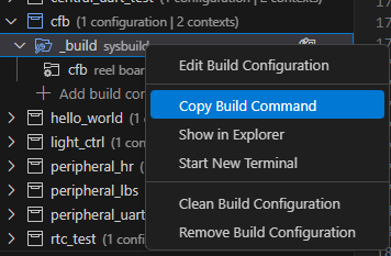

    Did you do any other changes? Can you please zip and upload the application that you are trying to build? Together with the build command you are trying to use? If you are using VS Code, you can right click the build folder and select "copy build command":
    Edvin
  • following the build command from VS code extension. I didn't change anything from the example (just added the build configuration)
    west build --build-dir c:/ncs/peripheral_hr_3/build c:/ncs/peripheral_hr_3 --pristine --board nrf5340dk/nrf5340/cpuapp/ns --sysbuild -- -DNCS_TOOLCHAIN_VERSION=NONE -DBOARD_ROOT=c:\ncs\peripheral_hr_3
