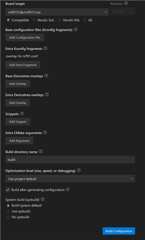

I create the project, start with a build using my DK and the overlay.

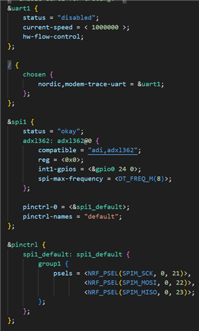

I remove the UART1 (trace) and replace it with SPI1, then I add teh adxl362 as a node into it, set the pins, add the label.

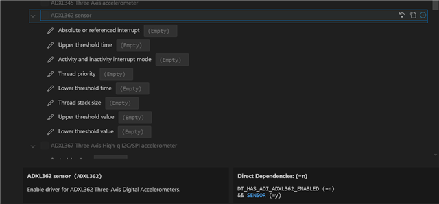

I navigate into kconfig gui to add the drivers and can not get the DT_HAS_ADI_ADXL362_ENABLED prereq to show up at y
I can not find this anywhere and have attempted to find out what this is but there is little information

    Okay, it was worth a shot at least. Can you try making sure your child node is enabled (set status = "okay") for that in your .dts/overlay file.
    If that doesn't work, I think I need some more information to help you out further here. Can you upload the compiled zephyr.dts, .config file and build log from your end here, so we can properly review what you're building?

    Thanks for the ongoing support. I still can not figure out where that pre-req is getting checked. I have set the status of that sensor to "okay" with no luck. I'm beginning to wonder whether the ADXL362 in the konfig gui is just setup for the thingy which has the sensor hardware on the board, and that configurations inherent to that board fill in that requirement.

    I deleted the build folder and tried again with no luck. Does anyone know what DT_HAS_ADI_ADXL362_ENABLED is actually looking for?
    This is not the case. The build system generates the DT_HAS_* Kconfig from DeviceTree node. As long as your node with the compat property is enabled, the Kconfig will be generated.
