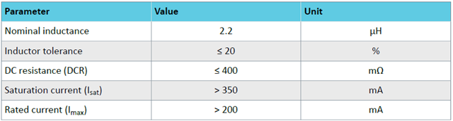

I have questions about nPM1300 VOUT1 inductor
1. Our load current for VOUT1 will be <20mA, so could we use below inductor?
2. Datasheet 6.3.5 define it's recommended DCR value is <400mohm, if >400mohm, except more power consumption, any other side effect?
Thank you
