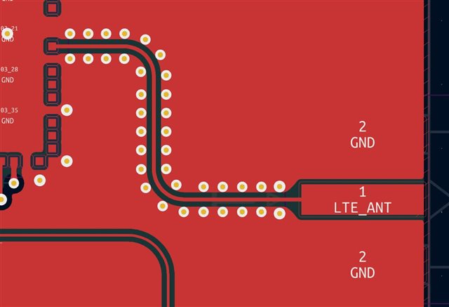

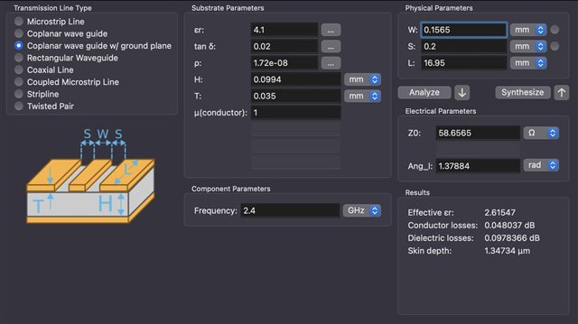

    I did go and re-check the impedance matching on our PCB design. We use a single strip coplanar waveguide with no matching components, the same as the Conexio Stratus Pro board. It turns out that I did in fact use an incorrect trace width. The updated calculation is below along with the trace geometry:
    As you can see the impedance should be 8 ohms off the target. Do you think this is significant enough to cause such severe signal loss on this short trace? Waiting for a new board to get manufactured and assembled is a stretch right now.
    I might try to measure the impedance with a NanoVNA but with no testpoints it might be difficult. I can also try to cut the trace and connect a coax to the start. Or I can try to put a series cap/inductor to try to compensate. Do you think any of these might work?
    Lastly, I can try what you suggested, swapping the SoC between my board and the development board but it might be risky, cause I worry the development board won't work after either.
  • Hi Jakub,
    Good to hear that you found improvement in the hardware.
    I'm not a hardware expert, but I know that some PCB manufacturers offer impedance control. For example, Controlled Impedance PCB Layer Stackup- JLCPCB. You may want to check with your manufacturer to see if they can provide guidance or assistance with this.
    I understand your concern. You can start by collecting logs and modem traces from your custom board. The signal strength might give some clues about your antenna performance. You can check this using AT+CESQ. See: Nordic DevZone Discussion for the expected RSRP.
    Charlie
