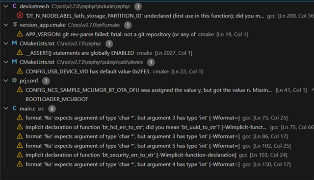

    I was wondering if that meant the board/memory chip wasn't working right, so I also tested the usbd_msc example from nRF5 SDK 11 and it worked just fine.  I had to format the drive, but it formatted and I was able to add a file.
    I also opened the project you sent and was not able to build it.  Here are the errors if you are interested.
    Sorry, I realize now that the project will not build out of the box with SDK v2.7.0 (are some minor API changes in main.c). It is probably easier to download SDK v2.9.0 and build against it. I recommend checking the terminal output for actual build errors and warnings. The "Problems" tab has multiple sources and the errors listed are not always relevant to the build.

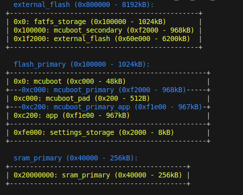

  • Hey Vidar,
    I updated to SDK v2.9.0 and I can build it with no issues.  I tried flashing the DK I have, but still the same issue.  I've tried it on my windows 11 machine, and 2 windows 10 machines.  The behavior is slightly different on windows 10, it says "Please insert a disk into D:", but 11 just says it needs to be formatted and then dies in the format.
    Here's the board I'm using:
    Well, alright, I just plugged it in again to copy the COM output for you and it works.  I get a drive :)
    The drive is only 0.98MB, though.  Here's the COM output.

  • Hey ian,
    Glad to hear that it seems to be working now. In my sample I was only allocation a portion of the flash to the fafs filesystem, see memory layout below. To use the whole chip, you have to relocate the mcuboot secondary slot to the internal flash (used to for staging FW updates during FW updates). This is if you want to support DFU.
    Using the whole external_flash region for fatfs_storage:
    1. Increase the size of the 'fatfs_storage' partition defined in the pm_static.yml file in the project root:
    fatfs_storage:
      address: 0x0
      affiliation:
      - disk
      device: DT_CHOSEN(nordic_pm_ext_flash)
      end_address: 0x800000
      extra_params:
        disk_cache_size: 0x1000
        disk_name: SD
        disk_read_only: 0x0
        disk_sector_size: 0x200
      placement:
        align:
          start: 0x1000
        before:
        - end
      region: external_flash
    2. In the sysbuild.conf file, comment the "SB_CONFIG_PM_EXTERNAL_FLASH_MCUBOOT_SECONDARY=y" line.
    3. Do a full rebuild.
    4. You can run "west build -t partition_manager_report" or click the "Memory report" button in the extension to view the new memory layout.
