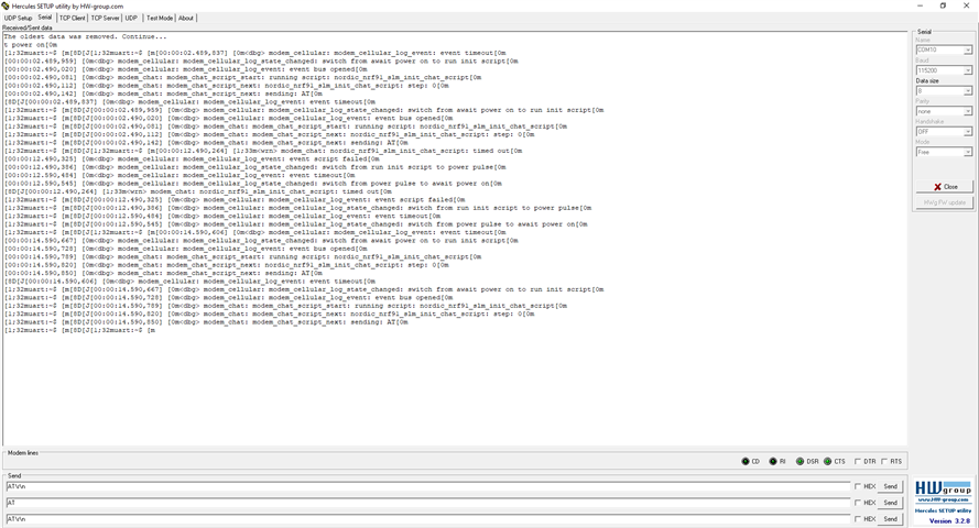

  • Hi Dejan,
    Now, i have know, where problem is. If I wanna build cellular_modem example, it doesnť work, cause this example works with EXTERNAL modem. This modem is conected via UART2, but if i don't have any external modem connected to my nrf9151-DK, it means that I am not able to run taht example correctly a connect modem to L4.
    But serial_lte_modem example works with INTERNAL modem.
    So this is why it doesn't work.
    So, now i mowed to serial_lte_modem and iI am trying to create PPP communication.
    Best Regards
    Jaroslav

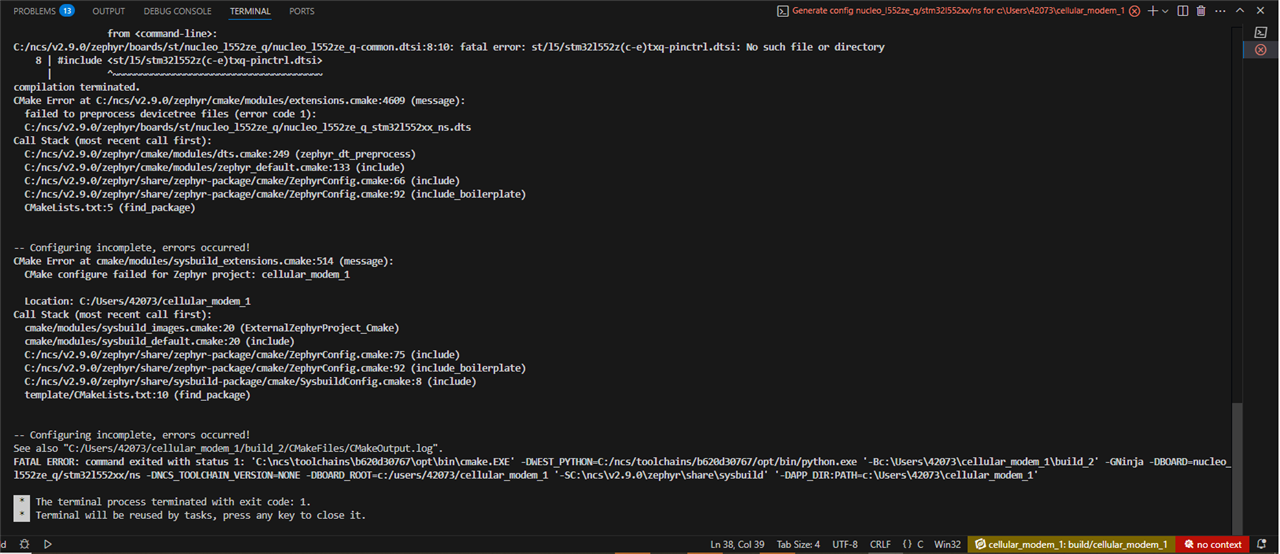

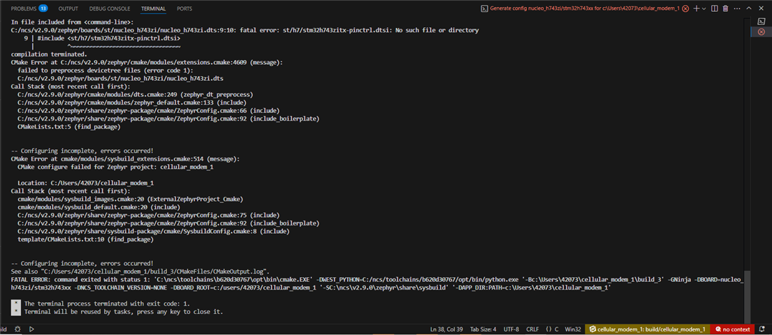

    Example serial_LTE_modem support AT commands like AT#XPPP and AT#XCMUX, but this example is no good for me, if I wanna explore PPP. I had to make tool, that will send over COM to nrf9151-DK HDLC packets, but very complicated and inefficient solution.
    But i try to build celluar modem with STM nucleo boards (when i want to connected nrf9151-DK with nucleo via UART), but I am not able to do it, because zephyr (SDK  v2.9.0) doesn't include .dtsi files.
    For nucleo F401RE
    For nucleo/stm 321552Z
    For nucleo/STM 32H743Z:
    Are you able to help me please or is this problem is for zephyr developers?
