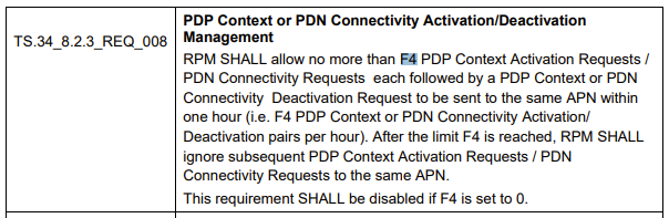

    In the log it seems that the first wake up from PSM is triggered by SIM activity. SIM card requests to establish a PDN connection with APN “teal”. The ESM cause #50 is normal when there is no support for IPv6. The PDN connection is successfully established and SIM card requests to disconnect soon, after which PSM is again entered.
    While in PSM sleep, SIM card requests again to establish PDN connection with APN “teal”. This time the request is rejected by modem because Radio Policy Manager (RPM) allows to establish PDN connection to the same APN only certain number of times per hour. The number (F4 in the figure below) is configured to the SIM card. I cannot see from the log what is the number in this case and I don’t know how many PDN connection establishments there have been before the log starts.
    More info of the Radio Policy Manager can be found from here: https://www.gsma.com/newsroom/wp-content/uploads//TS.34_v7.1.pdf
    A bit later, there appears uplink data to be sent, hence modem initiates Service Request procedure to establish data radio bearers. Once the RRC connection has been established, network sends Detach Request to UE asking to re-Attach. There is no more details in the PDU (causes etc.) so it is difficult to say the reason for this. It could be related to the prevented PDN connection establishment, i.e. network was waiting for the SIM card to connect but because it did not connect (it was prevented by RPM), network decided to require re-Attach. It could be something else, too.
    Has the customer tried using the SIM card in some other network? Is the result the same?
    Might be also good to ask the operator how often it is expected that the SIM card connects the network? In this log the second connection was triggered about 2 minutes after the first one was completed, so this seems quite a lot if it continues like this - It triggers PSM exit on every attempt. Also, it would be informative to know what is the RPM F4 value in the card. If it doesn’t exist in the SIM card, the default value to be used by modem for F4 is 30.
