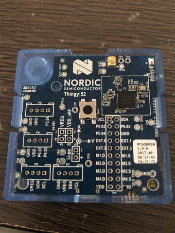

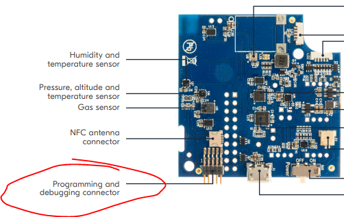

    Besides the 52840 DK and 5340 DK, I also have a Thingy52, but how do I flash it? I couldn’t find the SWD (SWDIO, SWCLK) on it.

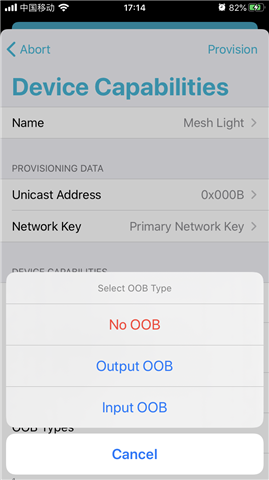

    What is OOB in Mesh?
    Out of band - something not related to a specific protocol. Typically you type the amount of LED blinks you see or something like that, I believe that app says what to do.
    I should start of by mentioning that much like the dongle, the Thingies also don't have programming ICs, meaning you need to use an external one. There is a programming 10pin connector sticking out on the bottom of it. Have a look here for further details on programming it.
