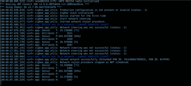

I've recently was checking out the Zigbee Weather Station application running on the Thingy53 and have spotted a weirdly formatted log message regarding temperature measurement.
Looks like the value was logged before it was converted to float so the sign character may be present in wrong place or possibly even duplicated. I think LOG_INF should be moved after the value is converted.

    The application shows the correct format on my side.
    It could be that your sensor is defective, or there is an issue with the communication between the sensor and the nRF5340. Can you try the BME68X: Gas Sensor sample and see if you get strange measurements with that as well?

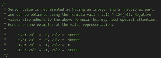

  • Sensor is working fine, only when temperature measured is below 0*C, log format has this issue.This is because how a sensor stores the value:
    And in the log the measurement is printed as two values (integer and fractional) - when temperature is below 0*C, fractional part can be negative and will be printed with minus character.
    So the temperature can be displayed as: [0.-980000] or [-1.-210000] but should be [-0.980000] or [-1.210000]

  • Hi Sebastian,
    The developers confirmed that this was a bug. This will be fixed in the next release of the Zigbee add-on. In the meantime, here is the sensor.c file with the fix.

     * Sensor value is represented as having an integer and a fractional part,
     * and can be obtained using the formula val1 + val2 * 10^(-6). Negative
     * values also adhere to the above formula, but may need special attention.
     * Here are some examples of the value representation:
     *      0.5: val1 =  0, val2 =  500000
     *     -0.5: val1 =  0, val2 = -500000
     *     -1.0: val1 = -1, val2 =  0
     *     -1.5: val1 = -1, val2 = -500000
