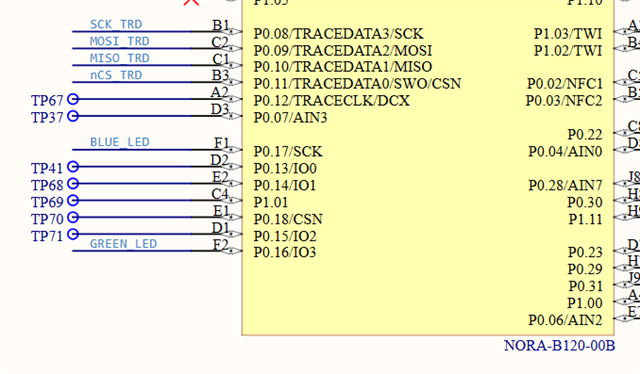

I have ported my already working nRF52840 SPI slave code to a nRF5340, but it doesnt seem to receive any data. I have verified the CS, SCK and MOSI signals, but no MISO from nRF5340.

    We need some help urgently as we are stuck at this point.
    After refering bit more on NORA B1 user guide, I come across this.
    "SPIM4: For the fastest SPI mode, the special purpose GPIO pins are enabled using the Peripheral setting of the MCUSEL pin of the PIN_CNF register. When activated, the SPIM PSEL settings are ignored, and the dedicated pins are used. The GPIO must use the extra high drive E0E1 configuration in the DRIVE field of the PIN_CNF GPIO register."
    I tried setting the MCUSEL to peripheral as follows.
    	#define SPIM4_SCK  NRF_GPIO_PIN_MAP(0,8)
    	#define SPIM4_MOSI NRF_GPIO_PIN_MAP(0,9)
    	#define SPIM4_MISO NRF_GPIO_PIN_MAP(0,10)
    	nrf_gpio_cfg(SPIM4_SCK, NRF_GPIO_PIN_DIR_OUTPUT, NRF_GPIO_PIN_INPUT_DISCONNECT, NRF_GPIO_PIN_NOPULL, NRF_GPIO_PIN_H0H1, NRF_GPIO_PIN_NOSENSE);
    	nrf_gpio_cfg(SPIM4_MOSI, NRF_GPIO_PIN_DIR_OUTPUT, NRF_GPIO_PIN_INPUT_DISCONNECT, NRF_GPIO_PIN_NOPULL, NRF_GPIO_PIN_H0H1, NRF_GPIO_PIN_NOSENSE);
    	nrf_gpio_cfg(SPIM4_MISO, NRF_GPIO_PIN_DIR_OUTPUT, NRF_GPIO_PIN_INPUT_DISCONNECT, NRF_GPIO_PIN_NOPULL, NRF_GPIO_PIN_H0H1, NRF_GPIO_PIN_NOSENSE);
    	nrf_gpio_pin_control_select(SPIM4_SCK, NRF_GPIO_PIN_SEL_PERIPHERAL);
    	nrf_gpio_pin_control_select(SPIM4_MOSI, NRF_GPIO_PIN_SEL_PERIPHERAL);
    	nrf_gpio_pin_control_select(SPIM4_MISO, NRF_GPIO_PIN_SEL_PERIPHERAL);
    But when I debug and check register at GPIO0-Pin 8, I see it is still set as APPMCU.
    So I have following questions.
    1. Can P0.8, P0.9 and P0.10 only be used as SPI4 in master mode, not as a slave?
    2. If SPI4 on the above pins can be used as a slave, how to do it?
    Cheers,
    Kaushalya
    It's a bit hard to decode the files, but looks like uart1 might be using port1 pin1. I would start looking there. Does the pin work as a normal gpio (if you don't use it for spis)?
    Kenneth
