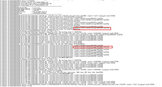

Hi all,
v2.8.0,sid_end_device demo.nrf52840dk,
From the above picture, it seems that the switch has failed. Is there any way to debug Lora?

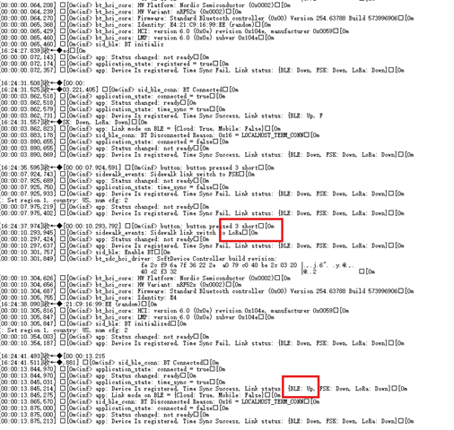

Hi
Can you try with the DUT sample and CLI overlay, and then try to activate LoRa and post the logs? I would also build for debug mode
Regards
Runar

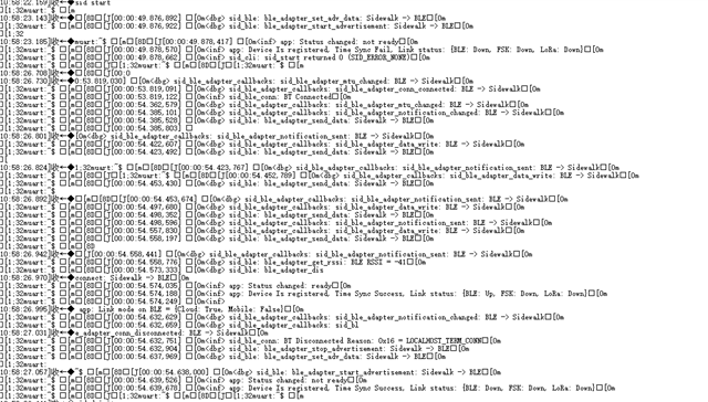

The method of using BLE(sid init 1 sid start) through CLI can be successful, but Lora cannot

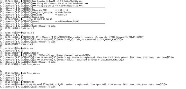

Most likely, it is caused by the use of a different crystal oscillator. The board I have is TCXO, and I have already opened a new issue.How to configure Lora as TCXO in Sidewalk - Nordic Q&A - Nordic DevZone - Nordic DevZone
Thanks for the update. I was going to ask if you had a custom board of DK+shield. Do you by the way know if FSK works?
It doesn't work.Is there a problem with the fail in the red box?
There is no 1262 shield
Thanks, then I suspect it might be related to the other case you crated regarding the crystal

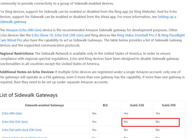

Hi Runar,
Does echo dot support Lora?
Hi, it should support Lora from what I can see, as far as i know we only test with 4th gen Echos internally so i have not tried the dot myself. The best would be to just ask Amazon if in doubt.
regards
Runar
Well yes, I would unfortunately say so.
Regards
Runar
