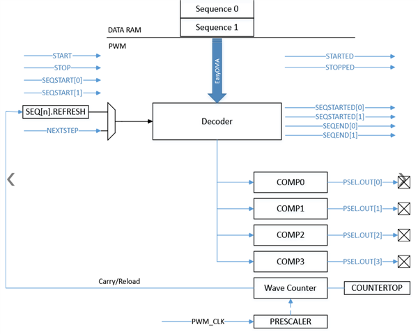

Stop and start PWM with a PPI
Is there anyway to start after stopping the PWM with a PPI channel?
There is a start task in the PWM, but
But not defined in the nrfx pwm driver (nrf_pwm.h)

I'm developing a battery application, and the PWM is only needed for a short time, in regular intervals.
  • Hi!,
    Yes, use NRF_PWM_TASK_SEQSTART0
    #include <hal/nrf_pwm.h>
  • Yes, use NRF_PWM_TASK_SEQSTART0
    No, it cannot start after stopping the PWM (it triggers only once after initialization).
  • Something is then maybe wrong with your PPI configuration.
    this simple "bare-metal" test shows that it can re-start using that task.

  • I have used the PPI to trigger GPIOTE and it works fine, but don't know why it not works with PWM, the code is below:

  • Hi!
    I will test your code.
    Could you let me know what SDK version you are using?
  •    I have the exact same issue in NCS v2.6.1 on the nRF52832!
    However, I found a workaround:
    static void pwm_handler(nrfx_pwm_evt_type_t event_type, void *p_context)
        NRFX_LOG_INFO("PWM handler");
        nrfx_pwm_simple_playback(&pwm_instance, &seq[0], 1, NRFX_PWM_FLAG_START_VIA_TASK);
    If I call the playback function in the PWM interrupt handler, my PPI-based TIMER looping works
    // Restart timer when the PWM has started the pulse
    nrfx_gppi_channel_endpoints_setup(gppi_channel_biphasic_started,
                                      nrfx_pwm_event_address_get(&pwm_instance, NRF_PWM_EVENT_SEQSTARTED0),
                                      nrfx_timer_task_address_get(&timer_inst, NRF_TIMER_TASK_START));
    nrfx_gppi_channels_enable(BIT(gppi_channel_biphasic_started));
    // Stop the PWM peripheral at the end of SEQ[0]
    nrfx_gppi_channel_endpoints_setup(gppi_channel_seq_end,
                                      nrfx_pwm_event_address_get(&pwm_instance, NRF_PWM_EVENT_SEQEND0),
                                      nrfx_pwm_task_address_get(&pwm_instance, NRF_PWM_TASK_STOP));
    nrfx_gppi_channels_enable(BIT(gppi_channel_seq_end));
    // Start PWM when timer runs out
    nrfx_gppi_channel_endpoints_setup(gppi_channel_biphasic_trigger,
                                      nrfx_timer_compare_event_address_get(&timer_inst, NRF_TIMER_CC_CHANNEL0),
                                      nrfx_pwm_task_address_get(&pwm_instance, NRF_PWM_TASK_SEQSTART0));
    nrfx_gppi_channels_enable(BIT(gppi_channel_biphasic_trigger));
    This isn't ideal though because the PPI should be able to restart PWM just by triggering the NRF_PWM_TASK_SEQSTART0 task.
    Maybe something in the playback start functions is locking out NRF_PWM_TASK_SEQSTART0 until it's called? Can someone on the NCS team possibly shed light on this  ?
    The full code I'm using is in a github repo.
    Edit 1:
    I did some testing and looks like setting enable register is the important part:
        nrf_pwm_enable(pwm_instance.p_reg);
    Is there some way to set a register via PPI?
