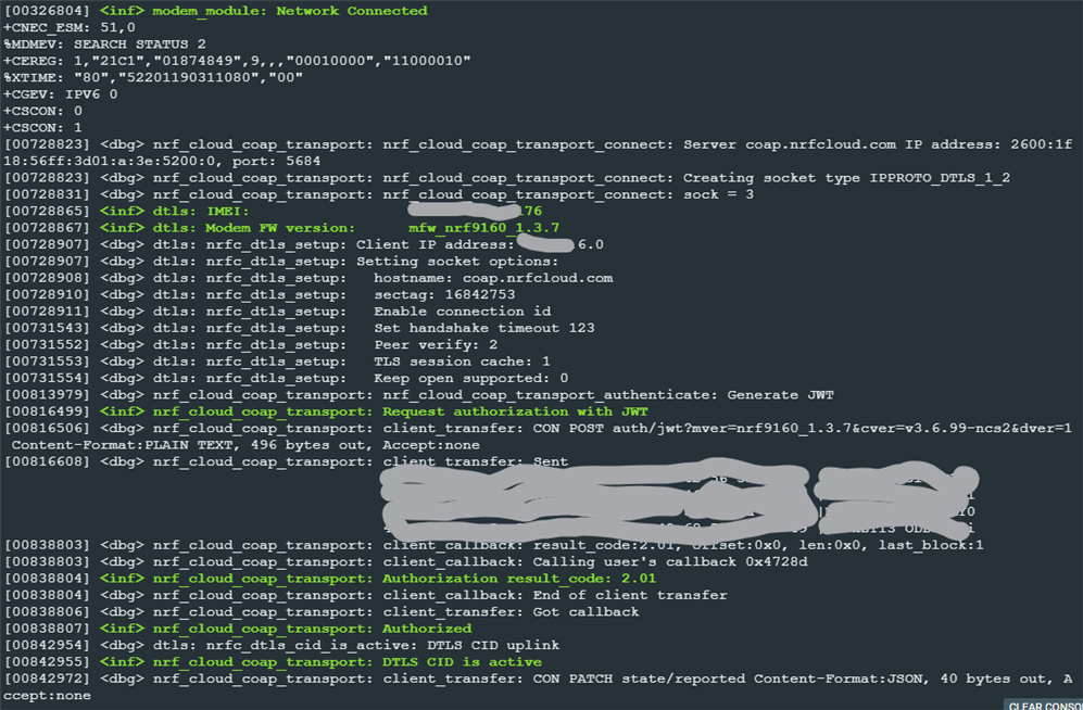

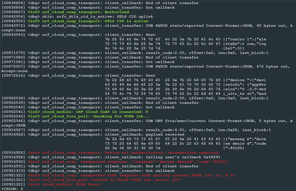

FOTA Authentication error - nRF9160
Hello
I am developing an application based on the nRF9160, it uses Coap protocol to connect to nRFCloud to transfer the data. Also I have implemented the FOTA which always worked with no problems but since last week I get an error, only when there is a pending fota on the nrf cloud for the device. Otherwise the device is able to connect and send data to nrf cloud without any problems. I get the following error: err> nrf_cloud_coap_transport: Device not authenticated; reconnection required.
For the device provision process I use the device_credentials_installer.py script from the nRFCloud utils on github . I have generated the CA certificate and private key using the script create_ca_cert.py.
I have never experienced a problem related with the provision and authentication of the device. I also, repeat the device provision using new generated certificates but did not solve the problem.
The fota in my application is based on the nrf_cloud_multi_service sample and the fota_support.c and fota_support.coap.c files.
The logs from my application when I there is a pending fota are the following:

As you can see from the LOGS the device is authorized but when there is a fota pending it says that the device is not authenticated. Also, in case there is not pending fota the device is able to get the shadow register and send data to nrfcloud using Coap protocol, without any problems. Why such an error might occur?

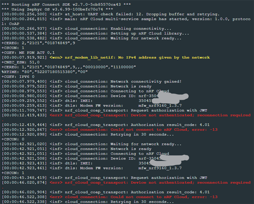

  • Hello Charlie
    I have tested the nrf_cloud_multi_service sample sample as you suggested with the following results:
    I performed two tests using two different SIM cards the one is IPV4 and the other one IPV6. In both cased it could not connect successfully.
    Following you can find the screenshots from the LOGS of both tests.
    Does this help to figure out what is going on?
    Btw, I tested again my code and I have exactly the same results as in my first post.
    Thank you!

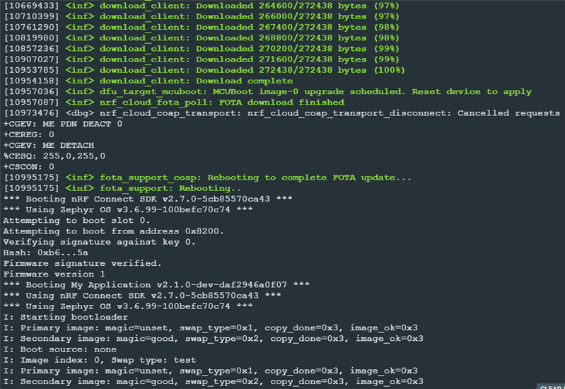

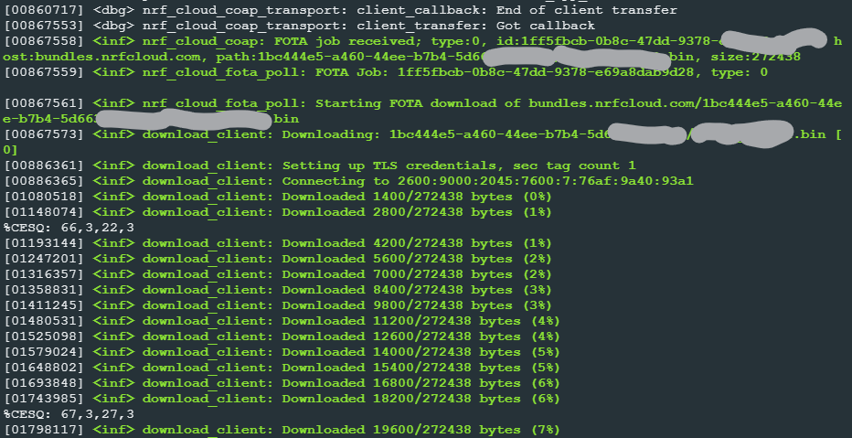

    Just an update, today I tried the same FOTA and it worked. I tried it also using another device of mine that there were no firmware change, just in case.
    As you can see in the following Logs of the device, the FOTA was successful.

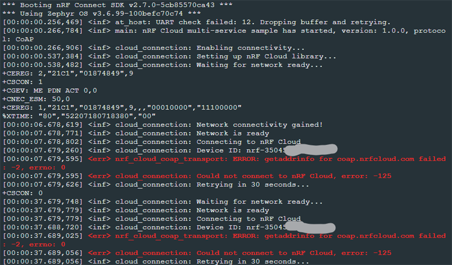

    Moreover, I also tried the nrf_cloud_multi_service sample, just to see what will happed and I had the same results as in my previous post. The sample was not able to connect to nrfCloud.
    Im not sure what is going on....?
