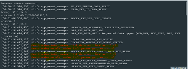

already i have connected one device using some modem firmware and hex file flashing and connected to nrf cloud and checked the data related to thingy91 and when i changed sim alread activated sim , then its not connecting and not sending data to nrf cloud.
    This seems to be an issue with the SIM card.. Could you verify the SIM card using the following commands after programming Serial LTE Modem sample and the latest MFW:
    AT+CFUN=4
    AT+CFUN?
    AT%XSYSTEMMODE=1,1,0,0
    AT+CEREG=5
    AT%CESQ=1
    AT+CFUN=1
    AT+CEREG?
    AT#XPING="www.google.com",45,5000,5,1000
    If you are able to ping google, but the connection to nRF Cloud still have issues, please do share the log and the modem trace..
