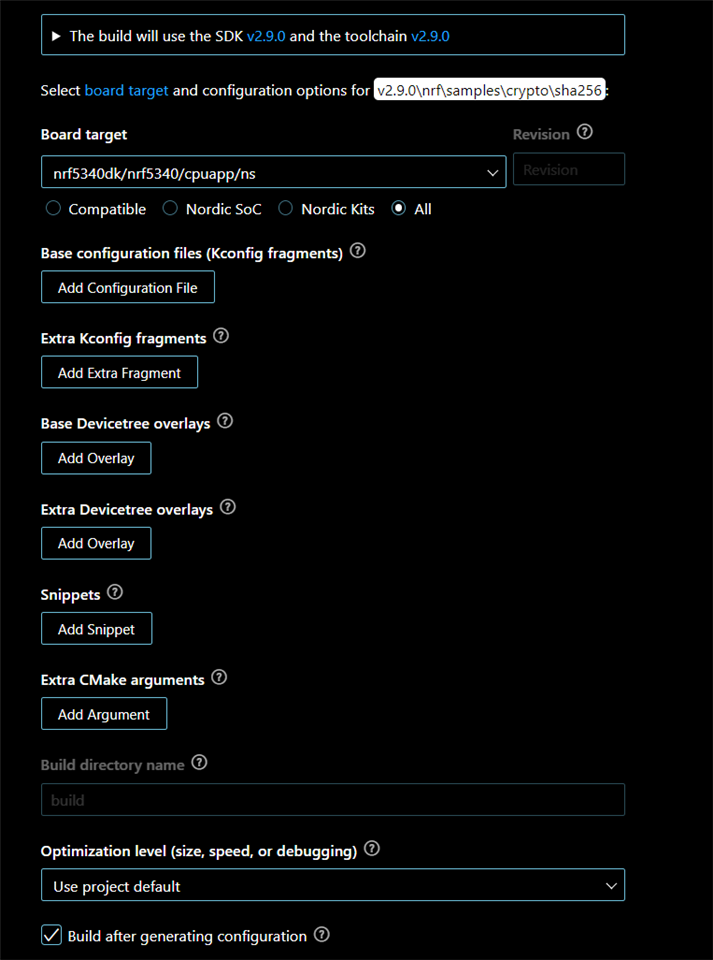

  • Hi Colin,
    I did a try the sha256 sample built with latest NCS 2.9.0 and NCS 2.7.0 on a nRF5340DK v2.0.0, and they all worked as expected.

    I do not quite understand the change you have made, did you expect to see the errors when your modifcation is applied?
    If you see the error with original sample, please have a try with the fimware I buildt on NCS 2.9.0. This firmware using ns so TF-M is enabled.

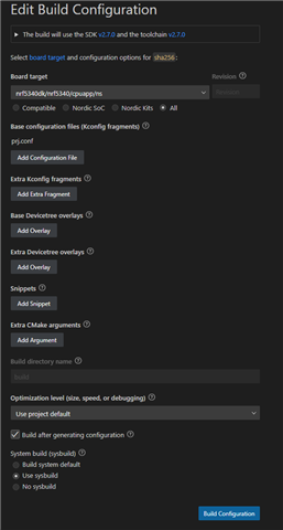

  • Hi Charlie,
    Thanks  for looking into it. Basically I commented out the return statements in the main function to let also hash_multipart_sha256 be executed in case only hash_singlepart_sha256 was failing. Otherwise I have not touched the SDK nor any other part of the sample.

    Here is the build configuration I used:

  • Hi Charlie,
    I Tested it with SDK v2.9 with the same build settings as your screenshot, it worked. Then I updated SDK v2.7 to make sure I hadn't alered it by mistake and it also worked.
    Then I found the real discrepancy: In my original buld config I had added prj.conf as base configuration file. I tried it again with prj.conf added and it failed. The build command looks like this :
    "west build --build-dir e:/BLE_Nordic/ncs/v2.7.0/nrf/samples/crypto/sha256/build e:/BLE_Nordic/ncs/v2.7.0/nrf/samples/crypto/sha256 --pristine --board nrf5340dk/nrf5340/cpuapp/ns --sysbuild -- -DNCS_TOOLCHAIN_VERSION=NONE -DCONF_FILE=e:/BLE_Nordic/ncs/v2.7.0/nrf/samples/crypto/sha256/prj.conf -DBOARD_ROOT=e:/ble_nordic/ncs/v2.7.0/nrf/samples/crypto/sha256"
    Without explicit usage of prj.conf in the build config the build command looks like this :
    "west build --build-dir e:/BLE_Nordic/ncs/v2.7.0/nrf/samples/crypto/sha256/build e:/BLE_Nordic/ncs/v2.7.0/nrf/samples/crypto/sha256 --pristine --board nrf5340dk/nrf5340/cpuapp/ns --sysbuild -- -DNCS_TOOLCHAIN_VERSION=NONE -DBOARD_ROOT=e:/ble_nordic/ncs/v2.7.0/nrf/samples/crypto/sha256"
    I will try comparing the .config output in both cases to understand the differences.
