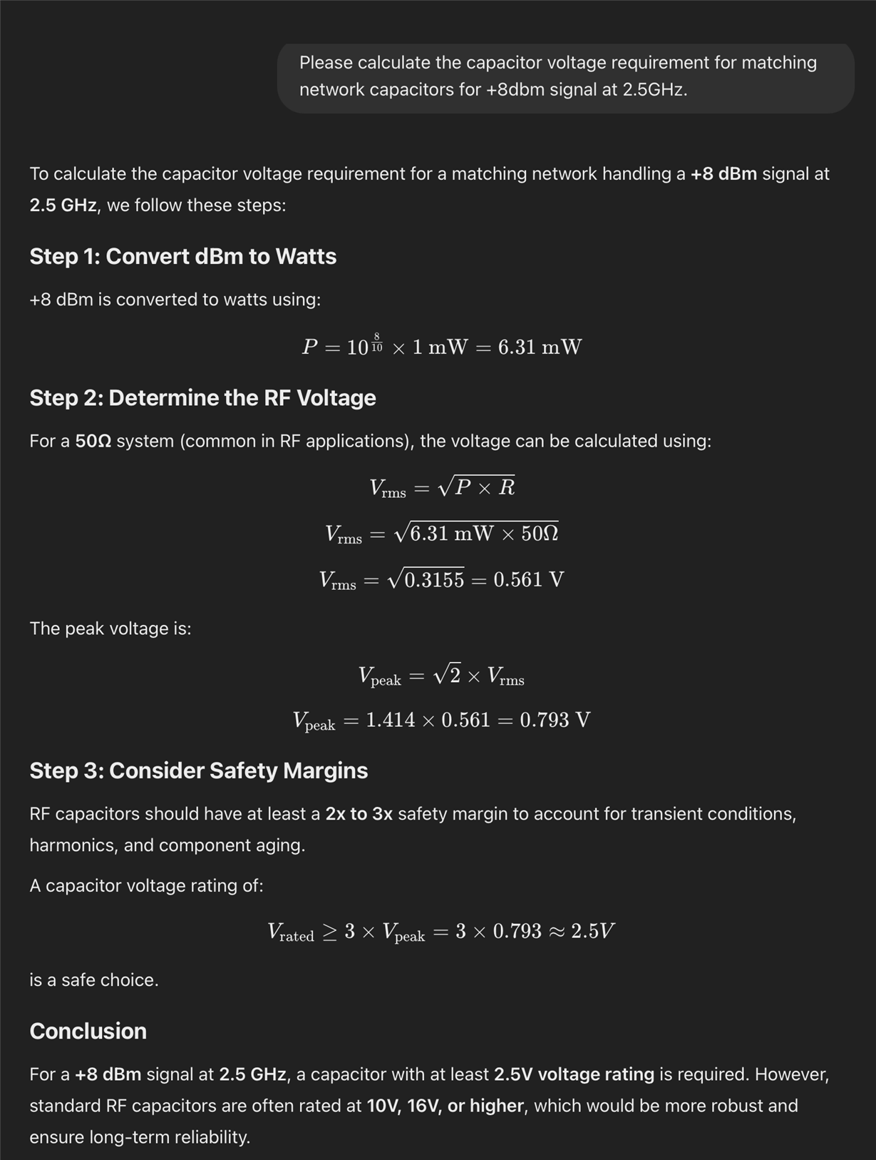

25V vs 50V rating for antenna matching capacitor
Hello!
We are working on nRF54L15, which has 50V 1.2p capacitors for the antenna matching circuit.
We also use other a few other capacitors in the antenna matching network (on the antenna part of the circuit).
Is there a practical difference between 25V and 50V for consumer applications?
Ilia
related AI prompt:
