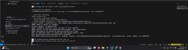

im trwing to use nRFconnect for my project, im using fade_led from example and got this error
i try run the "nrfjprog --program 'c:\Users\MIkhwanD\fade_led\build\zephyr\zephyr.hex' --sectoranduicrerase --verify -f NRF52 --snr 4294967295" with -- log to get the log

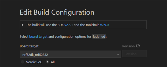

im using this build configuration
Notes :
I am able to flash my board using Segger Embedded Studio and run the ble_app_blinky_pca10040_s132 example.
Additionally, I have successfully connected to and erased the chip using J-Link Commander V8.12e.
