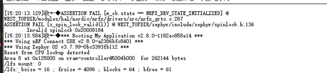

The Bluetooth firmware will report an error message before startup, and then everything will be normal
The chip I am using is 54l15, and the NCS version is 2.8.0
I used the peripheral_uart example for modification and got my own program, but I forgot which time this problem occurred during the modification
The specific error code is shown in the following figure
As can be seen, there was a slight error message output before the code started, but I searched for a long time without finding the cause. And this does not affect other functions, except for these few lines of error messages, everything else is running as expected
  • Another detail is that during the first boot after downloading firmware to the chip, this error message is usually not displayed. It is only seen during the second and subsequent boot attempts

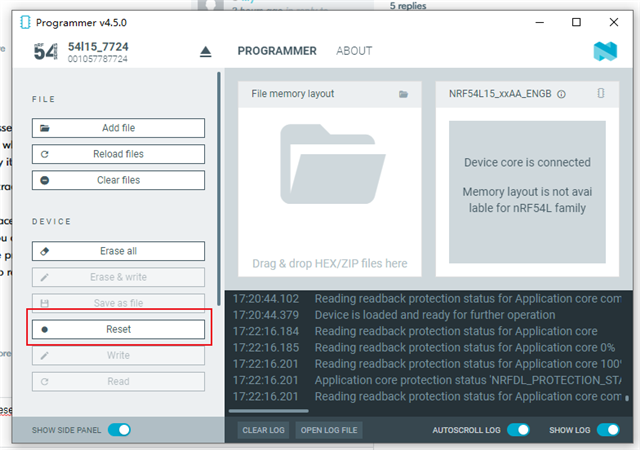

    Since our board does not have a reset button, I use soft reset on our board. Pressing two buttons at the same time will reset and restart. Additionally, during development, I prefer to use the programmer in nRF Connect for Desktop for resetting. Both of these methods can lead to this problem. Then I tested it using a 54l15pdk development board, and if I reset it using the reset button on the board, there would be no problem.

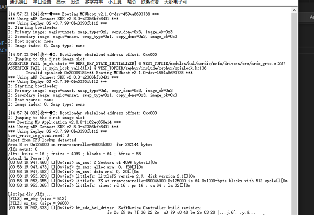

  • I have also printed out the information of mcuboot, and it seems that mcuboot has been started twice so far? Only the second time successfully redirected to the app and started running

    I think it's my mistake the assert is not about the grtc module has been initialized twice but about that the module is not initialized when the function is called.
    So we need to look into why it's not initialized when you do soft reset.
    I think it's easier if you can trace back on the modification you made to the application.
    GRTC is the peripheral replaced the RTC in the NRF52. GRTC is used for the system clock and for the application clock . Could you check if you have done any modification related to the clock ? Any chance that you remove the pre-kernel sysinit to start the sys_clock_driver_init() ?
    Could you show how you do reset ?
