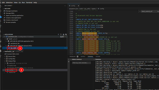

    1. The error message indicates that the network core is not responding. A common reason for this is if the network image is not configured with the same LF clock source as the application core. Please check the generated .config files for each project (ipc_radio and B0n if dfu is enabled) to confirm if the CONFIG_CLOCK_CONTROL_NRF_K32SRC_RC is selected or if it is enabling CONFIG_CLOCK_CONTROL_NRF_K32SRC_XTAL which is the default if building for the 5340DK board.
    If it is not selected, you can apply configuration changes to these projects by creating a folder named sysbuild in your project root directory with a Kconfig fragment for each image.
    <PROJ_DIR>/sysbuild/
    ├── b0n.conf
    └── ipc_radio.conf
    Note: it is neccessary to perform a pristine build after adding the sysbuild folder or new Kconfig fragments in the folder for the build system to detect the change.
