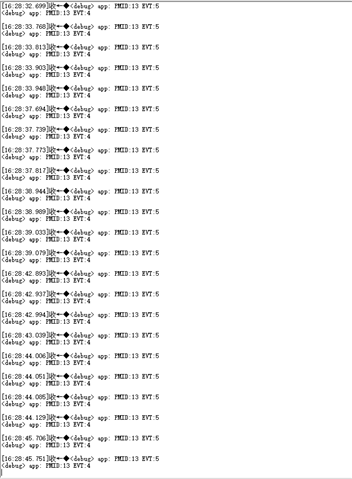

Due to the implementation of HID service, I can use my phone to connect directly to Bluetooth that advertised by my board.
After running for a while,I try to using my phone connect and bond with my board.The phone's Bluetooth keeps saying it's pairing.
The log of my board see as follow:
It tell me that PM_EVT_CONN_SEC_CONFIG_REQ and PM_EVT_CONN_SEC_PARAMS_REQ keeping be triggered.And it will keep until pairing failures are displayed on the phone.
How can I to deal it?
