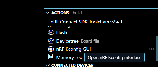

    You can check the configuration dependency and conflict from page Kconfig search.
    I think the better approach is to use the nRF Kconfig GUI for configuration, as it helps avoid conflicts and naturally follows dependencies.
    After finishing the setup, you can save the modified debug configuration as an overlay file and reuse it for future builds.
    You can check the final configuration used during the build in the build folder .config file.
