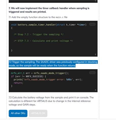

/* STEP 7.1 - Implement timer callback handler function */
void battery_sample_timer_handler(struct k_timer *timer)
        /* STEP 7.2 - Trigger the sampling */
        nrfx_err_t err = nrfx_saadc_mode_trigger();
        if (err != NRFX_SUCCESS) {
                printk("nrfx_saadc_mode_trigger error: %08x", err);
                return;
        /* STEP 7.3 - Calculate and print voltage */
        int battery_voltage = ((600*6) * sample) / ((1<<12));
        printk("SAADC sample: %d\n", sample);
        printk("Battery Voltage: %d mV\n", battery_voltage);
Would it not be more appropriate to get a call back from the nrfx_saadc_irq_handler when the conversion is complete?
When using the Zephyr ADC driver on the same exact board, it appears the ADC measurements are ~30 mV different.
Can you please confirm if we should be waiting for the conversion to complete here?

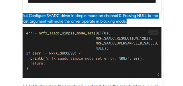

  • I figured this out.  I found NULL was passed as the event handler to this:
     * @brief Function for setting the SAADC driver in the simple mode.
     * The simple mode allows obtaining a single sample from each requested channel.
     * The conversion can be done in a blocking or non-blocking manner.
     * Sampling is initiated by calling @ref nrfx_saadc_mode_trigger() once.
     * @param[in] channel_mask  Bitmask of channels to be used in the simple mode.
     * @param[in] resolution    Resolution configuration.
     * @param[in] oversampling  Oversampling configuration.
     * @param[in] event_handler Event handler provided by the user. In case of providing NULL,
     *                          the conversion will be performed in the blocking manner.
     * @retval NRFX_SUCCESS             Initialization was successful.
     * @retval NRFX_ERROR_BUSY          There is a conversion or calibration ongoing.
     * @retval NRFX_ERROR_INVALID_PARAM Attempt to activate channel that is not configured.
    nrfx_err_t nrfx_saadc_simple_mode_set(uint32_t                   channel_mask,
                                          nrf_saadc_resolution_t     resolution,
                                          nrf_saadc_oversample_t     oversampling,
                                          nrfx_saadc_event_handler_t event_handler);
    I wish this was more clearly written out.

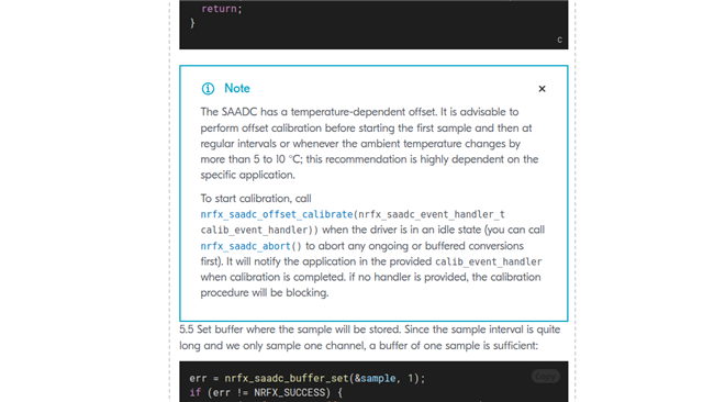

    Also the offset discrepancy was caused by not calling
    nrfx_saadc_offset_calibrate() prior to starting the conversion in the sample.
    Thank you for the feedback. I will relay this to the team responsible for this course. I also think it is worth mentioning about the calibration. The blocking part appears to be covered already in the updated course:
    Vidar
  • The team has added a note about SAADC calibration in the course now:
    Thanks again for your feedback.
