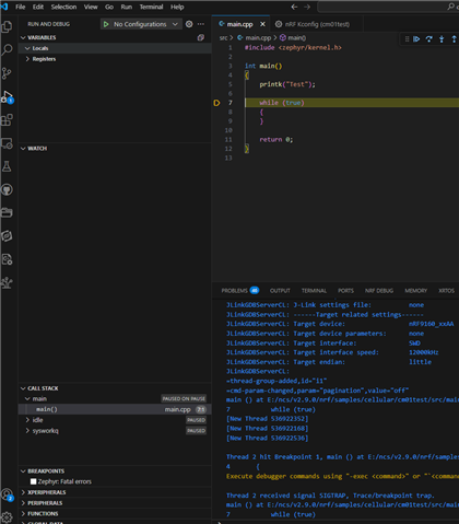

  • Just ran your project at my end and I see no assert. The main is running for a while in debugger and without debugger quite fine
  • wait, seems like you are running this in linux with tools outside the nrf connect sdk.
    I used windows with tools that came with nrf connect sdk v2.9.0
    If you are testing this outside the toolbox that we recommend for our sdk, then I cannot test all those combinations. Please try to install our sdk and run your example with our toolchain that comes with it.
