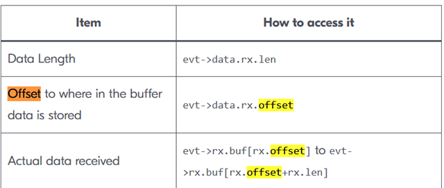

    The event data can be set as non-zero in the UART_RX_RDY in the UART callback. We can see in the driver documentation from devacademy course UART Driver - Nordic Developer Academ, the offset to where the buffer data is stored.
     The offset can change, especially when using features like chained buffer reception or when dealing with larger amounts of data that fill up the buffer in multiple UART_RX_RDY events.
    ''The UART asynchronous API offers a way to perform chained buffer reception. You can declare multiple buffers to seamlessly switch between them when the current buffer is full. To do this you need to call uart_rx_buf_rsp() on the event UART_RX_BUF_REQUEST, which will provide the next buffer. When the current buffer is filled, receiving will automatically go to the next buffer.''
