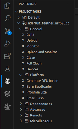

    1) Enable DFU in Your Code (Using PlatformIO & Arduino Framework)
    If you're using PlatformIO for software development with the Arduino framework, start by enabling DFU mode in your code using dfu.begin(). In the PlatformIO interface, you’ll see an option called “Generate DFU Image”. Click on it, and it will generate a firmware.zip file. Transfer this ZIP file to your phone.

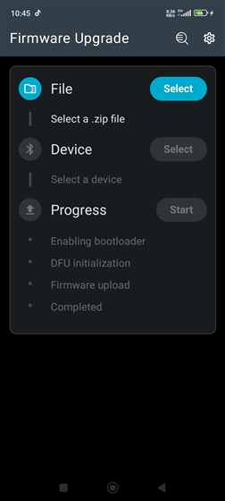

    2) Use the “nRF Device Firmware Update” App
    Download the nRF Device Firmware Update app on your phone. Build and flash your code with the DFU changes. Open the app — you’ll see an interface where you can select a .zip file. Note: On some phones, the firmware.zip file might not appear. In that case, upload the ZIP to a Google Drive folder, and access it from there via the app. After selecting the file, choose your device from the list, You can choose your device by MAC ID and name of the device. Make sure Bluetooth is enabled on your phone. Once selected, tap Start to initiate the firmware update.

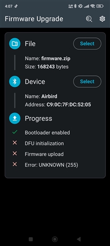

    After clicking Start, you’ll see a message like “Bootloader enabled”. At this point, the device will switch to DFU mode, and its name will change to “DfuTarg” or something similar. You must now select this device (e.g., “AdaDfu”) to continue. However, you may encounter an error like “DFU Initialized” followed by “Error: Unknown (255)” during the upload.

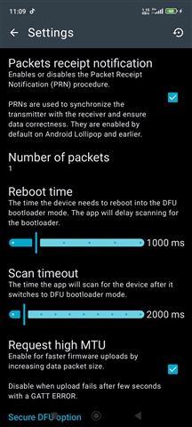

    4) Fixing the Error (Unknown 255)
    To resolve this, go to the app’s settings and Set Packet Receipt Notification (PRNs) to 1 (default is 12). Increase the reboot time to 2000ms or 3000ms. Then, repeat Steps 2 and 3. This should allow the firmware upload to proceed successfully.

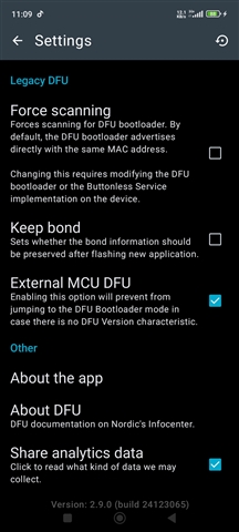

    5) Preventing Reconnection Errors

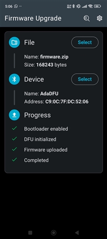

    To avoid the error in Step 3 (having to reselect “AdaDfu”), enable the setting “External MCU DFU” in the app. With this enabled, repeat Steps 2 and 3. This time, your firmware.zip should upload, and you should see messages like “Firmware uploaded” and “Completed”.
