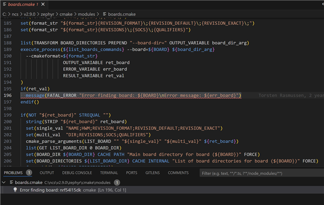

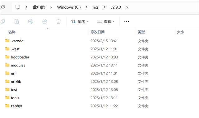

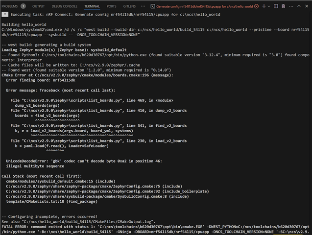

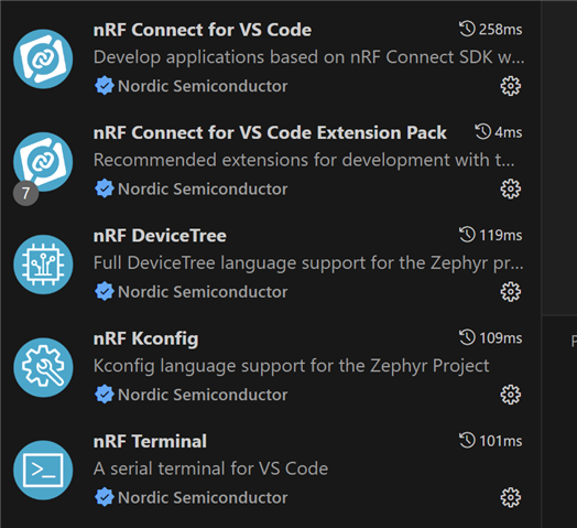

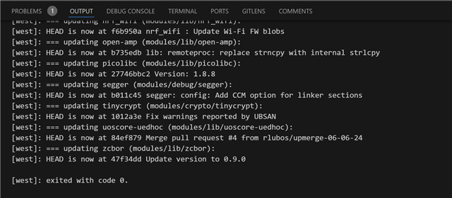

When configuring the build in the VSCode development environment using the "hello world" example, an error occurs.
I have installed the nRF Connect SDK, with both the toolchain and SDK set to version V2.9. I selected the nrf54l15dk board for development, but I do not have a physical nrf54l15dk board connected. When configuring the build in the VSCode development environment using the "hello world" example, an error occurs. What is the cause of this, and how can it be resolved?
thank you.
