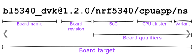

    This might be easier if you are aware of the board terminology. A board target consists of a board name, revision (if relevant), and board qualifiers. The board qualifiers are things such as SoC, CPU cluster (cores) and variant.
    I will use the diagram from Board Porting Guide as an example:
    The full board target here is [email protected]/nrf5340/cpuapp/ns and breaking it down into board name, revision and board qualifiers we have the following:
    • Board name: bl5340_dvk
    • Board revision: 1.2.0
    • Board qualifiers:
      • SoC: nrf5350
      • CPU cluster: cpuapp
      • Variant: ns
    As mention in the porting guide, this can also be seen as board name[@revision][/SoC[/CPU cluster][/variant]].
    When you make a custom board, you should rename all instances of the "board name" part of the files to correspond with your board name. I know I said earlier that, for example, nrf5340dk_common.dtsi does not need to be renamed, and this is still true, since this file is only included locally in the board files. However, I would still recommend changing all places where the board name itself is used if you want to follow the standard convention.
    You do not need to rename the files that do not have the board name in the filename, e.g. nrf5340_cpuapp_common.dtsi.
