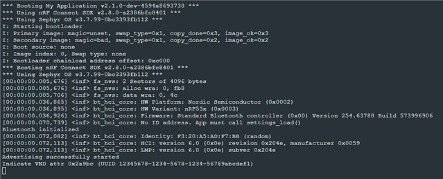

    Here is my example peripheral_key.7z for NCS v2.8.0 nRF5340 mcuboot using QSPI external flash.
    The log would look like this:
    Beware that this code/configuration is not fully tested or qualified and should be considered provided “as-is”. Please test it with your application and let me know if you find any issues.

  • Hi Amanda
    Thank you for your help. With the additional instructions your example compiles and runs.
    Using your example I was able to figure our my problem: The file structure in the sysbuild folder was wrong. It is quite confusing the ncs also contains example code from zephyr which does essentially the same thing, but does not work. By bad luck I used zephyr/samples/sysbuild/with_mcuboot as example. And it uses a different file structure in the sysbuild folder.
