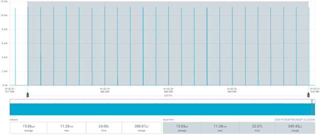

I've allready reduce a little the consumption by:
- fixing the interval to 1000ms at 0dB (sd_ble_gap_tx_power_set(BLE_GAP_TX_POWER_ROLE_ADV,m_adv_handle,RADIO_TXPOWER_TXPOWER_0dBm); & #define NON_CONNECTABLE_ADV_INTERVAL    MSEC_TO_UNITS(1000, UNIT_0_625_MS) )
- activate the DCDC converter with the 32KHz clock (sd_power_dcdc_mode_set(NRF_POWER_DCDC_ENABLE );)
- disable uart on the sdk_config.h
- create a Custom_Board
Here are my measure 15.83uA

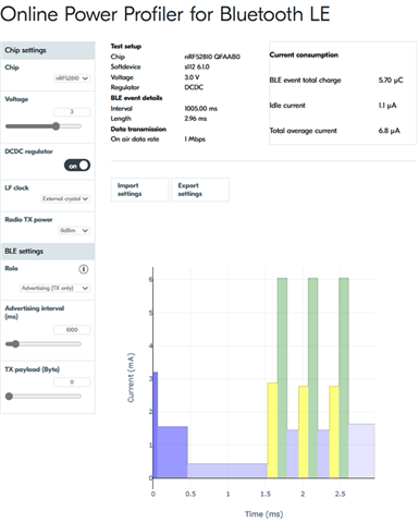

I've find 6.8uA on your Online Power Profiler:
Is there others ways to reduce more the consumption ?
