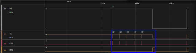

    The flow control pins are active low, and I see from the logic analyzer trace that the pins are low most of the time (though it is difficult to see the details as it is zommed out). I also see that there si a bit of data exchanged, but it is difficult to see. Can you elaborate on how this works or not (what are you attempting to send/receive, compared to what you do)? Also, how is the hardware connected? Did you for instance mix up so that RTS and CTS are not crossed?
  • Yes you are right, from 9160 the first transaction does work but when a large data needs to sent then it does not work(it doesnot reaches to 5340) Also I am getting UART TX ABORTED error

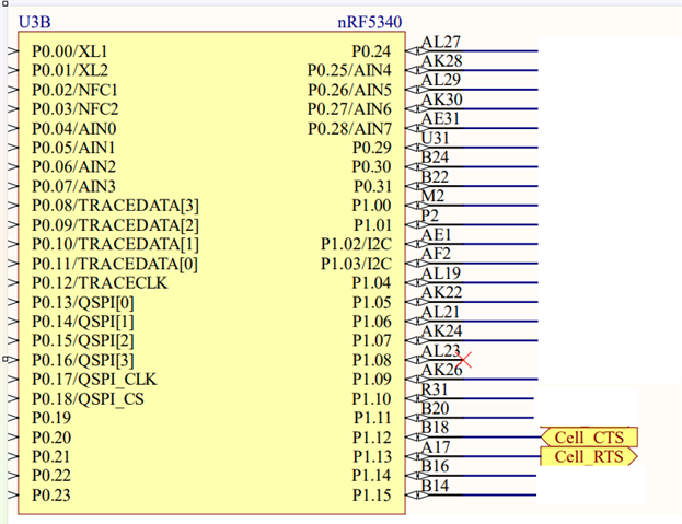

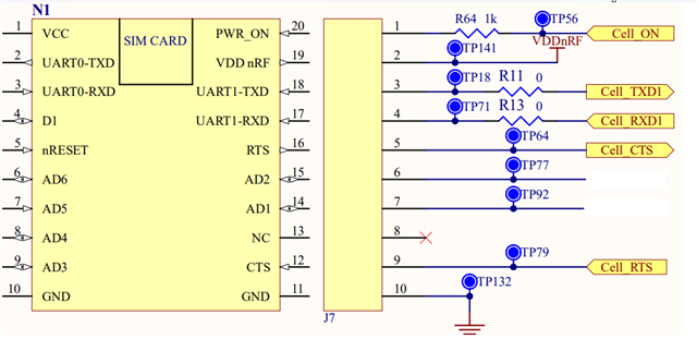

    I see. This shows you disabling flow control. Can you show how you have connected the pins between the nRF9160 and the nRF5340? And how the pins are configured? I ask becasue I wonder if there is an issue in the connection (RTS and CTS pins crossed, perhaps?)
  • nrf5340:
    Signetik with nrf9160:

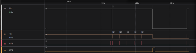

    The flow control signals are active low, so here the CTS is low for most of the time (meaning the other device can send data). Could it be that you have swapped the RTS and CTS lines? Does swapping them help?
    That aid, I notice that the CTS pin in this plot is high for every byte, meaning flow control is used for some reason. Could it be that you have set up single byte UART buffers, and that explains it? Can you double check and if so, increase UART buffer sizes?
    If that is not it, I would suggest testing on two DKs if you have them and if you can reproduce there as well, I can have a look at the code and tets on my end. If you can only reproduce on your HW, we need to look more closely at that.
