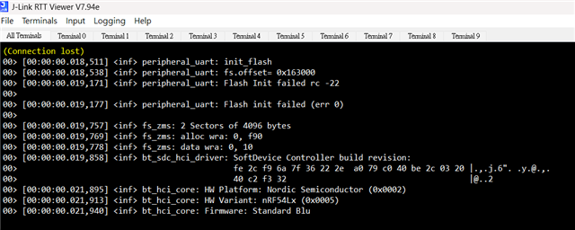

nRF54L15 Zephry Flash init error -22

Issue: Added Zephyr NVS Flash support but encountered error -22 from nvs_mount(&fs). Additionally, data cannot be saved successfully.
The settings were referenced from a Zephyr sample (Refer.1), and I obtained fs.offset = 0x163000. However, I am unsure how to check storage_partition since I cannot find the actual setting in the code also debug the problem
#Error

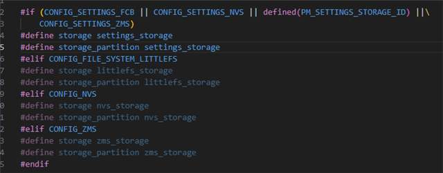

#storage_partition

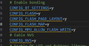

#prj setting

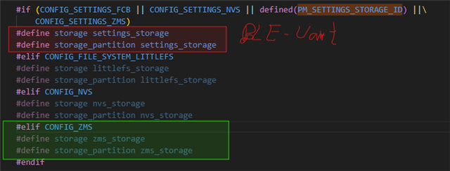

    I’m still encountering the same problem in BLE_UART, but ZMS initializes successfully when using the non-BLE blinky sample.
    As you mentioned, this might be a flash map issue.
    The only difference I found is in the flash_map_pm.h settings:
    BLE_UART: settings_storage (RED) → Init failed, fs.offset = 0x163000
    Blinky: zms_storage (Green) → Init OK, fs.offset = 0x15F000
    It seems no more setting value can check in "flash_map_pm.h",
    Only can change the setting "CONFIG_ZMS=y" in prj.conf

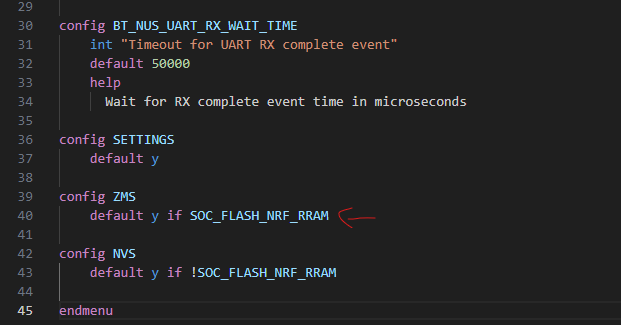

  • Hi AHaug

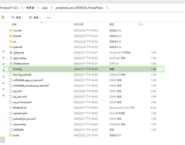

    I check my project's Kconfig setting, it seems already match the solution(Attached the  Kconfig code ).
    But I still got the same error. Did I miss something  ?Thanks.
    My SDK Version is:2.8.0
    # Copyright (c) 2018 Nordic Semiconductor
    source "Kconfig.zephyr"
    menu "Nordic UART BLE GATT service sample"
    config BT_NUS_THREAD_STACK_SIZE
    	int "Thread stack size"
    	default 1024
    	help
    	  Stack size used in each of the two threads
    config BT_NUS_UART_BUFFER_SIZE
    	int "UART payload buffer element size"
    	default 40
    	help
    	  Size of the payload buffer in each RX and TX FIFO element
    config BT_NUS_SECURITY_ENABLED
    	bool "Enable security"
    	default y
    	select BT_SMP
    	help
    	  "Enable BLE security for the UART service"
    config BT_NUS_UART_RX_WAIT_TIME
    	int "Timeout for UART RX complete event"
    	default 50000
    	help
    	  Wait for RX complete event time in microseconds
    config SETTINGS
    	default y
    config ZMS
    	default y if SOC_FLASH_NRF_RRAM
    config NVS
    	default y if !SOC_FLASH_NRF_RRAM
    endmenu
