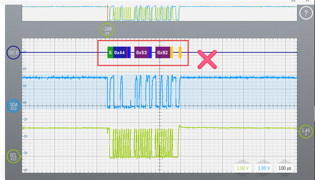

we have nRF54H20DK (SoC rev. "C"). connected to MAX77655 via I2C (SCL ~ P1.0, SDA ~ P1.4 according to I2C restriction).

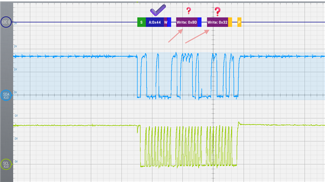

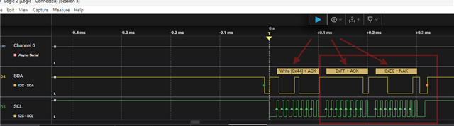

I am trying to test i2c131 for reading/writing data but I can only transfer the first byte (I2C Maxim IC address = 0x44). The other bytes seem to be random and do not depend on the input parameters of the I2C function.
I want to send 3 bytes, but without success.

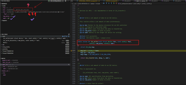

value "ret" != 0

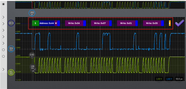

  • Many thanks for this fix. It works now.
