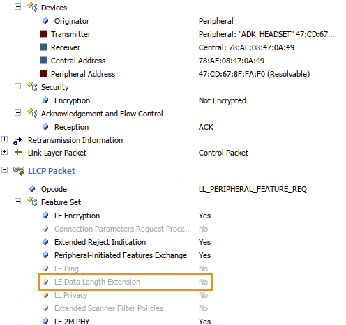

    I am using NCS 2.9.0 with the nRF5340 audio application built as a unicast_server. The ADK is not setting the LE Data Packet Length Extension bit in the LL features. See attached screenshot from Ellisys. (Note that Ellisys misnames this by not including the word "Packet.") In case you're wondering, the Central I'm using does set this bit.

  • Okay, silly me. LE Audio likely doesn't need LE Data Packet Length Extension because this was an ACL feature long before the ISO channels of LE Audio came along.
