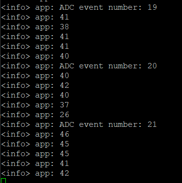

I've used saadc example in the SDK, and results of the conversion are not what I expected. I also connected the analog pin (P0.03) to GND, and the results were not 0V.
I'm sharing result of GND:

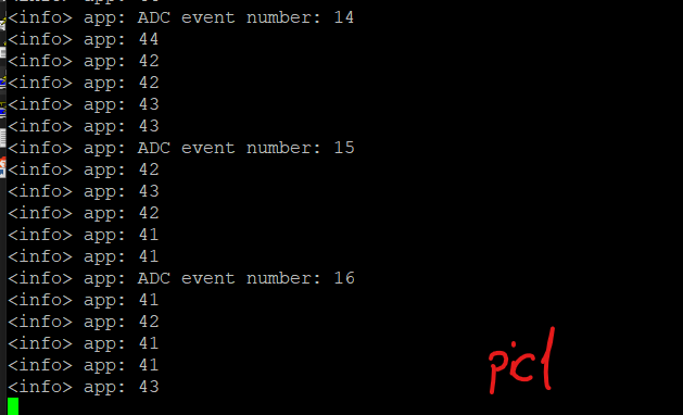

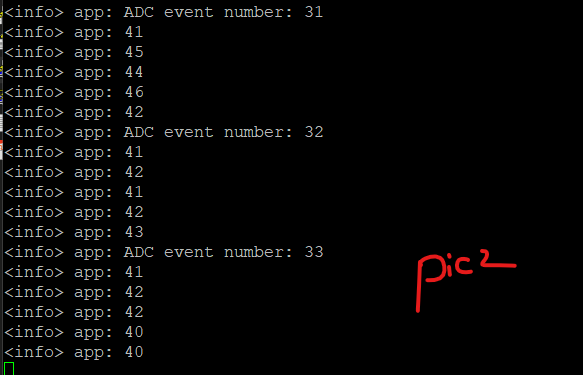

Also sharing result of a test circuit that uses potentiometer to change input voltage:
I changed the resistance of potentiometer bw pic.1 and 2.

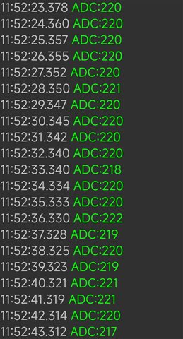

Result of the test code:
What is the mistake that I've done? Thanks for your help!
