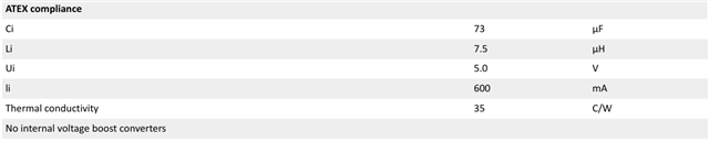

Does the NRF9151 modem have ATEX compliance information available, similar to the NRF9160?
Hi Lucas,
The ATEX parameters of the nRF9151 are as follows:
Ci = 86uF,
Li = 8.8uH,
Ui = 5.0V,
Rth=40 C/W,
Ii = 600mA

Hi Lucas,
Ci = 86uF,
Li = 8.8uH,
Ui = 5.0V,
Rth=40 C/W,
Ii = 600mA
