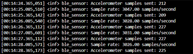

    Let's say each sample is 4 bytes. Then you would need to achieve a throughput of 4 bytes * 8 bits/byte * 3000 samples = 93.75 kbps, which I expect should be possible for most connections with a decent link quality. But you will definitely need to include multiple samples in each notification packets to be able to transfer  >3000 samples / second.
    Here is a demo project you can use to test how many number of samples you can send from your device to a client:
    send_sensor_samples.zip
    Vidar
