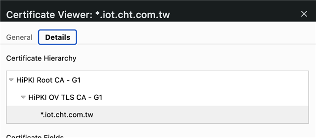

https client error 113
sample code: https client
sdl version: 2.6.2
board: 7002dk
question: https client cannot connect to iot.cht.com.tw
log:
*** Booting nRF Connect SDK v3.5.99-ncs1-2 ***
HTTPS client sample started
Bringing network interface up
Connecting to the network
[00:00:02.183,166] <inf> wifi_mgmt_ext: Connection requested
[00:00:06.844,177] <inf> net_dhcpv4: Received: 192.168.0.31
Network connectivity established and IP address assigned
SNTP time: 1739958786.977459479
Now: Wed Feb 19 09:53:06 2025
Provisioning certificate
delete sec tag(0): 42
Looking up iot.cht.com.tw...20.188.24.130 (AF_INET)
Connecting to iot.cht.com.tw:443
[00:00:12.823,394] <err> net_sock_tls: TLS handshake error: -0x7080
connect() failed, err: 113
Looking up example.com...23.215.0.138 (AF_INET)
Connecting to example.com:443
Sent 85 bytes
Received 345 bytes
> HTTP/1.1 200 OK
Finished, closing socket.
Network connectivity lost
Disconnected from the network
modifications:
1. change pem file because I doubt it is out of date. (in fact it is not. and I did not change back)

then I use openssl to check, date valid
% openssl x509 -noout -text -in cert/DigiCertGlobalRootG2.pem
Certificate:
Data:
Version: 3 (0x2)
Serial Number:
68:69:4e:10:01:fb:a7:b1:72:a6:b4:8d:10:74:c7:dd:8c:b7:fb:ca
Signature Algorithm: sha256WithRSAEncryption
Issuer: C=AU, ST=Some-State, O=Internet Widgits Pty Ltd, CN=192.0.2.2
Validity
Not Before: Aug 9 07:48:39 2022 GMT
Not After : Dec 25 07:48:39 2049 GMT
and curl to test iot.cht.com.tw, it can be connected

* Server certificate:
* subject: C=TW; L=\U81FA\U5317\U5E02; O=\U4E2D\U83EF\U96FB\U4FE1\U80A1\U4EFD\U6709\U9650\U516C\U53F8; CN=*.iot.cht.com.tw
* start date: Dec 16 09:45:19 2024 GMT
* expire date: Dec 16 09:45:19 2025 GMT
* subjectAltName: host "iot.cht.com.tw" matched cert's "iot.cht.com.tw"
* issuer: C=TW; O=Chunghwa Telecom Co., Ltd.; CN=HiPKI OV TLS CA - G1
* SSL certificate verify ok.
    Could you try with "HiPKI Root CA - G1" instead?
    Håkon
  • How? That is server certificate, I could not ask them to change?
  • You need to add "HiPKI Root CA - G1" to your project and use that for verifying this specific domain.
    Here's a screenshot from my browser when inspecting the domain:
    Håkon
  • How to add to my project? I searched Kconfig GUI and not found.
  • I found HiPKI Root CA - G1 at https://eca.hinet.net/repository-h/download/HRCA_b64.crt
