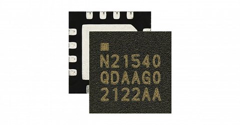

    • Have you considered a front end module with LNA/PA? https://www.nordicsemi.com/Products/nRF21540
      nRF21540 Range Extender
      www.nordicsemi.com
