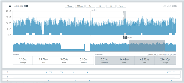

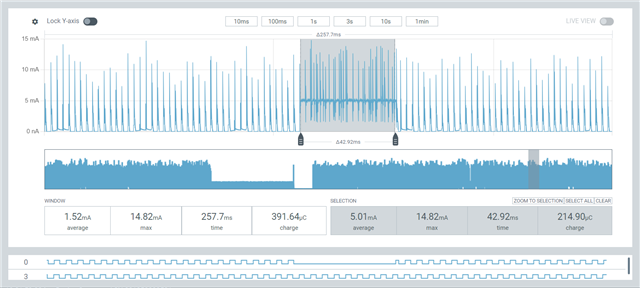

I am porting the code (especially for PTX) over to nRF54L15DK and NCS v2.9.0 (based off nrf\samples\esb\), in order to have a device that's more power optimized than what the nRF53 could provide. But I see an issue occurring several times per second where the PTX is unable to send packets for a period of 20-100ms. In addition, the average current draw shoots up to around 5mA for that period of "being unable to send packets" (and as a result, the average current overall shoots up as well). I added LED toggles in the PPK2 digital channels to confirm this (channel 0 is on LED0 and toggles on each ESB_EVENT_TX_SUCCESS, channel 3 is on LED3 and toggles on each esb_write_payload() call).
I replicated the issue based off the NCS "nrf\samples\esb\" examples. See screenshots here, and my attached projects that I used to produce these results. Note that PTX project was flashed onto nRF54L15DK, & PRX and empty app core projects were flashed onto nRF5340DK...I did also briefly try the NCS v2.9.0 ESB PRX sample on another nRF54L15 (so 2 nRF54's, one sender and one receiver) but seemed to have similar results.

This is a very critical issue that we need to solve for our project; otherwise it will be a show stopper for us. Why does the current draw increase, almost as if the processor is blocking/waiting for the ESB packet to be sent off?...I would really appreciate any help regarding this ESB issue. Thank you in advance!
