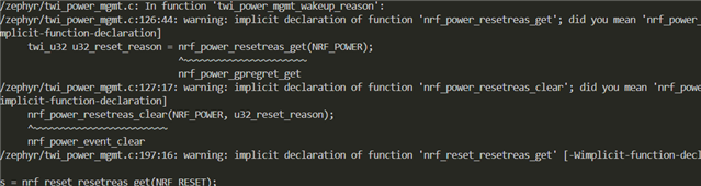

I am using nRF Connect SDK v2.9.0. While working on the nRF52840 board, I used sys_poweroff() to put the board in deep sleep mode. But before calling it, I called
HI,
The system off demo demonstrate retention if build with CONFIG_APP_USE_RETAINED_MEM=y. The RESETREAS exist on nRF54L15 as well, but is handled a bit differently in the SDK. You can refer to the print_reset_reason() function in the NFC system off sample which show how you can read it (the sample only decodes reasons relevant for the NFC sample, though).
When I added CONFIG_APP_USE_RETAINED_MEM=y, I got "attempt to assign the value 'y' to the undefined symbol APP_USE_RETAINED_MEM"
Also, I want to configure the retention in the running time before calling sys_poweroff()
In the reset reason, when I used print_reset_reason() function, I Got the same errors
