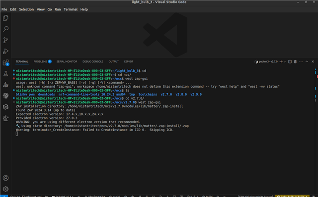

    Are there any errors when running the "west zap-gui" command, or only when using the "west zap-generate" command? Are you running the command from a terminal where the nRF Connect SDK environment is set up, such as an nRF Connect terminal in VS Code?
    Marte

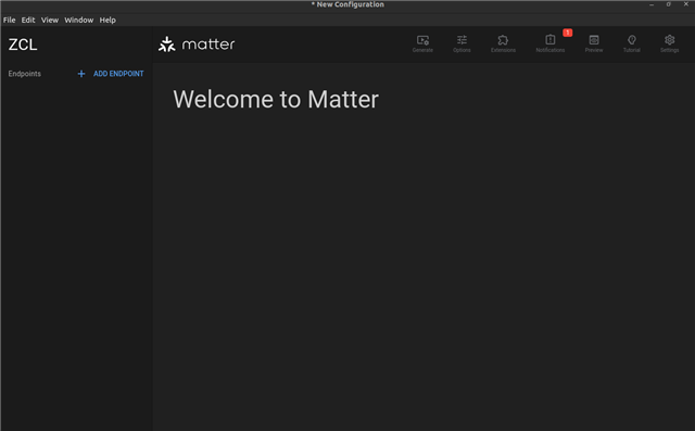

  • following interface open when "west zap-gui" command use

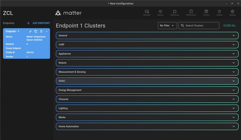

    after addition of cluster i generate
    using this we can add cluster as above correct me if i'm wrong.

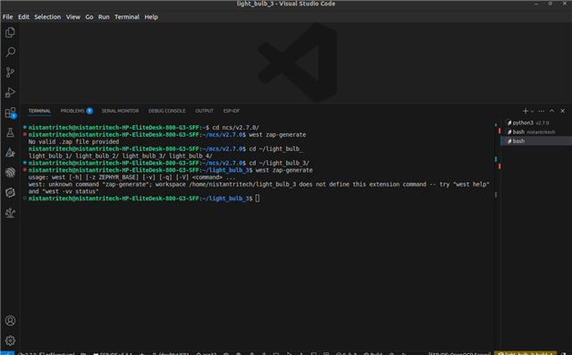

    after generating cluster i use "west zap-generate"  command showing error
    path for "west zap-gui" on same path i use "west zap-generate" showing "No valid .zap file provided" because zap file inside the sample code light_bulb so at that location i use
     "west zap-generate" command then showing error
    "usage: west [-h] [-z ZEPHYR_BASE] [-v] [-q] [-V] <command> ...
    west: unknown command "zap-generate"; workspace /home/nistantritech/light_bulb_3 does not define this extension command -- try "west help" and "west -vv status"
    yes, Command running form terminal where nRF Connect SDK environment is set up.

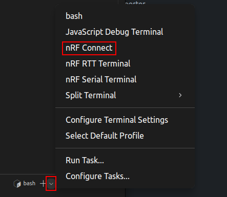

    The issue is that the bash terminal does not have the environment set up unless you are inside the SDK folders. Can you try running it from an nRF Connect terminal in VS Code instead of bash? You can open an nRF Connect terminal by clicking the error next to the plus sign in the terminal and selecting "nRF Connect," or by opening the command palette (Ctrl + Shift + P) and finding the "nRF Connect: Create Shell Terminal" option.
