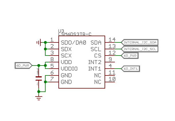

I’m working with the Seeed Studio XIAO BLE Sense to acquire data from its integrated IMU (LSM6DS3TR-C).
I found that the Zephyr SDK (nRF Connect 2.9.0) already includes a sample for the LSM6DSL sensor at:
  •  samples/sensor/lsm6dsl
Additionally, the board definition for the XIAO BLE Sense is located in:
  •  xiao_ble/nrf52840/sense
The build completes successfully, but when I try to debug, the initialization of lsm6dsl_dev fails, returning:
  • sensor: device not ready
I am using the sample code as-is, which I have attached below:

Additionally, I noticed a potential issue with the regulator in the Device Tree Source (DTS):
/dts-v1/;
#include "xiao_ble_common.dtsi"
#include <zephyr/dt-bindings/i2c/i2c.h>
#include <zephyr/dt-bindings/gpio/nordic-nrf-gpio.h>
	model = "Seeed XIAO BLE Sense";
	compatible = "seeed,xiao-ble", "seeed,xiao-ble-sense";
	msm261d3526hicpm-c-en {
		compatible = "regulator-fixed";
		enable-gpios = <&gpio1 10 (NRF_GPIO_DRIVE_S0H1 | GPIO_ACTIVE_HIGH)>;
		regulator-name = "MSM261D3526HICPM-C-EN";
	lsm6ds3tr-c-en {
		compatible = "regulator-fixed-sync", "regulator-fixed";
		enable-gpios = <&gpio1 8 (NRF_GPIO_DRIVE_S0H1 | GPIO_ACTIVE_HIGH)>;
		regulator-name = "LSM6DS3TR_C_EN";
		regulator-boot-on;
		startup-delay-us = <3000>;
Questions
1. Is the LSM6DSL sample compatible with the XIAO BLE Sense board?
2. Why is the sensor not ready?
3. Do I need to modify anything in the device tree or driver?
Since the IMU on the XIAO BLE Sense is LSM6DS3TR-C, but the sample refers to LSM6DSL, could this be causing the issue?
Any insights or suggestions would be greatly appreciated!
