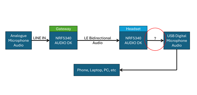

I'm using two NRF5340 Audio DKs — one as a Gateway and one as a Headset — running the nrf5340_audio example.
  1. Is it possible to configure the Headset device to output audio via USB while maintaining audio input through I2S (LINE IN) on the Gateway?
  2. How can I integrate an external electret microphone on the Gateway to replace the built-in PDM MEMS microphone?
Currently, I'm using LINE IN on the Gateway with an external microphone, but the audio is sent to the Headset as audio data. When output through the Headset, it is recognized as audio data rather than microphone data. I'm currently using an external DAC on the Headset device in this set up but I would like to use the NRF5340 to do this task instead.
Thanks!

  • I'm using SDK v2.8.0. I have attached an illustration to give more context, essentially my current problem is getting USB audio out the Headset device. An ADC on the LINE OUT of the Headset is my temporary solution which works, but I would like the NRF5340 to do DAC and output via its USB-C. I'm aware the Gateway device is capable of this but I would like to use the Headset device. .
    The figure also says "bidirectional audio", but the arrow is going in one direction only. Are you expecting sound both ways?

  • Essentially im trying to create an Auracast microphone. The Gateway broadcasts the signal, & multiple Headsets receive the audio signal. The Headsets would be a simple USB dongle (Receiver).
    I'm trying to get the Headset to output its audio through the USB, and would then need to change the USB audio data to be recognised as microphone audio data.
    The USB output data from the Headset needs to be in USB microphone data format so the PC for example recognises it as microphone data and not audio data which cant be an input.
    I'm using the 'LINE IN' on the Gateway for the microphone yes. This line in data is sent as Audio data and not Microphone data to the Headset. So at the output of the Headset there is Audio data and not Microhpone data, how ever this can be switched around.
    Applogoes I by mistake put biderectional, I meant unidirectional audio. Thank you for your response.

  • Hello Oliver,
    I got a reply from our LE Audio team:
    So the question is: Can we use USB as audio interface on the receiver side (especially the BIS Receiver)?
    To me, I think the answer is yes, but would require to make some modifications.
    1. Basically for now, only the gateway could use USB as audio interface, and once if we enabled the CONFIG_STREAM_BIDIRECTIONAL and CONFIG_AUDIO_SOURCE_USB, then the gateway will enumerate the USB audio input/outout device.
    2. So the customer could check the code from audio_system.c to see how the USB audio interface is initialized for the gateway, and do something similar for the headset (receiver side). And make sure the receiver packets will go to:
    https://github.com/nrfconnect/sdk-nrf/blob/16f066f9cdba59feba988a3a7123a828de764953/applications/nrf5340_audio/src/audio/le_audio_rx.c#L151
    3. Be careful. The current application will not support USB async mode, so the clock is controlled by the PC, so there could be a chance that the drift could happen and cause some USB overrun/underrun issue.
