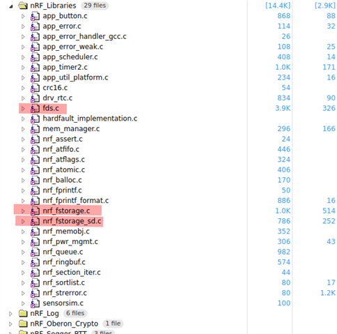

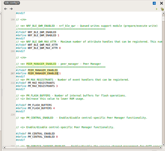

    I reviewed the ble_app_hrs example as you suggested, and I attempted to integrate it into our project. However, there are many new defines and source/include files. When I add all the necessary defines and files to the makefile of the project, I encounter memory overflow errors.
    Is there a way to identify which specific defines and files are necessary for LESC Just Works, and which ones can be excluded?

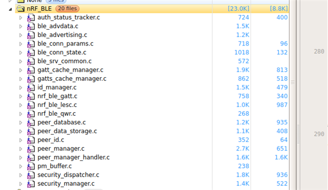

    You need the peer manager module and its dependencies in addition to fds and fstorage to allow for persistent storage of bonds in flash.
    I couldn't get it to work with just these changes. I encountered many errors, and each time, I had to add a new module to the config or include additional source files in the Makefile. In the end, I had to structure everything exactly like the example to get it working.
    Do you have any other suggestions?
    Also, does the legacy Just Works version require the same dependencies? Does it have the same level of security as the LESC Just Works?
    There is not any other way than to add the missing dependencies. I can help with this if you are able to share your project.
