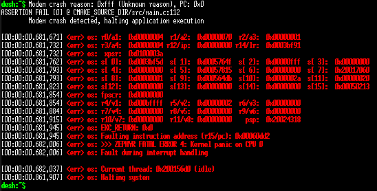

dect shell example always calls nrf_modem_fault_handler at init
Im using two Thingy:91 X, Toolchain is v2.9.0. I build and flash the dect shell example. I select build configuration thingy91x/nrf9151/ns. No other changes.

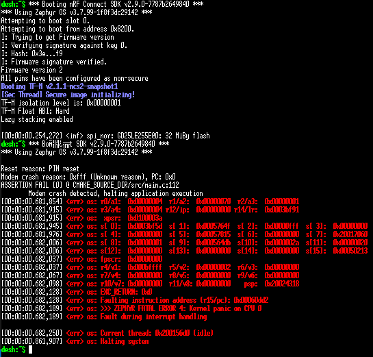

Both devices report modem crashes on the terminal and stop further execution:

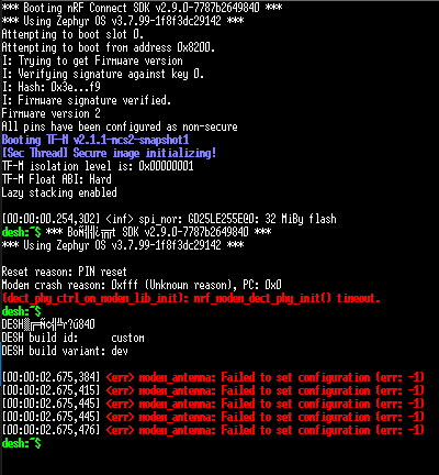

If i use button 2 for reset, the output is a little longer, but essentially the same:
If i remove the assert in the nrf_modem_fault_handler, it crashes on some other dect phy command.

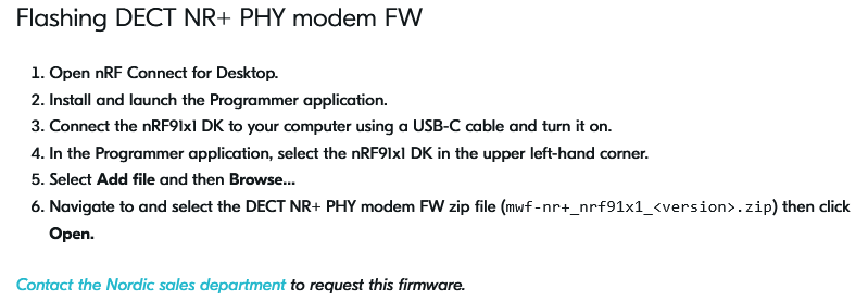

Is there a fundamental step im missing for using DECT NR+ with the Thingy:91 X?
