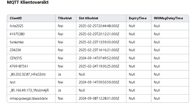

  • hey, forgot to say something the error messages come from the broker because of a topic policy (i think)?
    AND all messages are delivered and work fine.  only Client id is problem/Clan sessoin. part.
    Here excerpt from the communication between us and mqtt melger support:
    i ask supprt:
    Could the policy error message have something to do with it not recognizing the client ID? Before I send the clan session.
    Admin say: No. It has already determined the clientid before it starts to try and consume things
    but you said that i can see in the NRF log i haven't done that. can i see MQTT logs there? or do i have to turn it on in the configrue is it default there?
    list of Clients all client with IP-ADDRESS IS nRF devifes.
