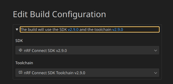

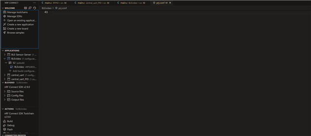

I want to change me SDK version, but I cannot open the welcome page to change. As some tickets recommended this way.

In newer versions of the VS Code Plugin the SDK Version is not changed globally for VS Code but within the Build Configuration.

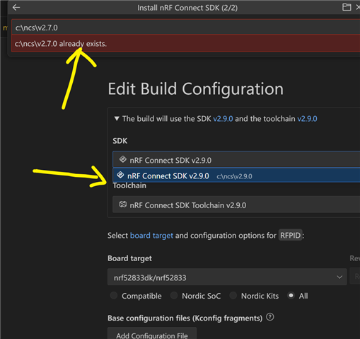

Thank you so much for your reply. My problem is though I have ncs 2.7 in my folder. I can not use it.
looks like something went wrong during installation, manually remove 2.7.0 from the ncs folder and install again, in my experience the install sometimes fails if it takes too long due to a bad internet connection
